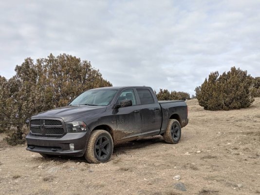

I plastidipped my wheels a few months ago, it's holding up great. Been through mud, dust, car washes, snow, salty roads, no peeling or anything. I just did it right over the chrome clads, I didn't even take the wheels off. Just make sure they're nice and clean and put plenty of coats for durability and for ease of removal later. I do suggest masking the tires though. I didn't because the YouTube videos make it look easy to remove but it's kind of a pain because toward the edges it's really thin and comes off in really small pieces

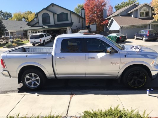

I did it to my chromies. Put down 3 coats of black, 2 pearlizer, and 2 clear. You can see the process in my picture below. Have had it on now for about 2 years. No issues. Just clean the surface really well first, then use playing cards to keep your tires from getting painted. Also use plastic bags in the spokes to keep everything clean.
