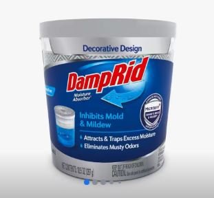

Windshield sweat among other things is humidity. Make sure you air out truck and beware when you have on recirculate, you need sometimes to exchange the air in the truck due to humidity. ALSO, take a GOOD window cleaner and clean da chit outta all the interior windows. Dirt you cannot see will accumulate moisture. On my 2019, I also have a container of damp rid I keep in the center console and filled as needed. HEY, if he offers to have rear window replaced, oh yeah, expensive thing to do. ( you do not need to do damp rid, I put in to help because of humidity issues here, just MY preference)

Warranty FCA Backlite-1.jpgWarranty FCA CHMSL.jpgRear Interior Backlite frame cracked-Friedman-2019 Ram 1500 5th Gen.jpgDamprid.JPG

I put a container of damp rid in it and its not wicking anything after 5 days now. so I'm at a loss really how i keep getting the excessive sweat. i had a neighbor mention it could be a heater coil issue? does that sound like something that could be the cause?

You've also got the mentioned brake light, rear vents and rear window. And checking for a clogged AC vent. Any of those things could cause water inside the cab. I wouldn't go by Damp-rid how fast it wicks; I've used it for years in my basement and it's decent enough but I have a humidity monitor down there and the humidity is still high in the summer even with the damp rid unless I run a dehumidifier.
