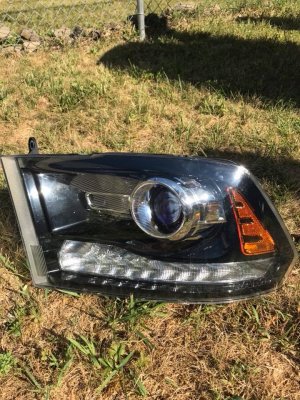

Would it be a plug-N-play to swap out stock quad headlights for stock projector headlights? If it is not plug and play, what would be involved?
Included in the sale is this harness...

I did this upgrade to my truck, contact retroshop and ask those guys. I bought a harness off them and they know what's exactly needed. By looking at the picture of the wiring harness it almost looks like its frayed?

I agree, the right harness looks damaged. From what I've seen in different write ups as I was searching this exact topic, you will need the headlamps and the harnesses. If you plug them in and they work, try to get some more heat wrap on that plug and call it a day.

The harnesses are also missing the resistors. I called Jeremy at Retro Shop, he said I would have to get new harnesses.
Would the Lights be worth $400 with out the harness? They’ve got about 100,000 miles on them, he said normal wear.

My $.2 not worth $400 considering you can get the tyc replica brand new for around $450-500 and the outputs a little better then the oem projectors. Now it is was say around $300 I would do it and just polish the lense and seal em and call it a day.

Ok, that is what I was thinking, I offered him $300 yesterday but he wouldn’t come down. Just wanted to make sure I wasn’t to far off on my offer. Thanks
