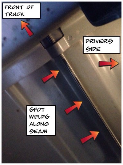

This is what mine looks like underneath. Everything is tight and spot welded. I assume this is where yours is separated.
2013bighorn
Jun 2, 2015
16
Hemingway 5.7
Yes even under that strap at the front, the pannels are not lined up correctly and there is a gap. All the welds seem to be intact. The gap starts there and goes back towards the bed 18 inches On the drivers . The passenger side crack is only about 5 inches and not as wide. The body shop said they would pull the bed, cut all the spot welds, separate the bed sides and start over aligning the panels, reweld and paint where needed.
