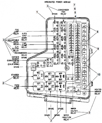

Hi 17CrewCab1500, thanks for following up.
Regarding the relay for autostop, Below is the diagram for the relays in the vehicle at the fuse box. The ASD relay, automatic shut down relay, controls the ignition coil, and fuel injectors among other things. Based on it controlling these 2 things and that control starting of the vehicle these are the primary roles I focused on when troubleshooting the ASD. I did swap the relay in early testing with a new relay and was able to confirm with a power tester that I am getting power to the ASD and to the PCM from the ASD. The amount of DC at the fuse block and PCM match what they should be.
Is there another relay you are referring to?
