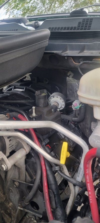

Hey all,
Currently running a vararam. I am finally going to swap out for the 6.4 manifold and s&b cai. I believe the stock hose where I now have the mini filter (pictured below) is the positive crankcase ventilation hose that connects to non vararam intake styles at the tube after the filter. Is that correct? That hose is long gone and I would like to get another one. I'd rather just run the stock hose to the intake tube rather than plugging the intake tube and having to keep changing this mini filter out. Thanks in advance.

Actually, I think I'm wrong, pcv hose should be coming from near the pcv valve... wtf is the hose I need then?

Where that filter is, usually there is a cross over tube that goes over the intake to another junction on the passenger side where you would connect the breather to the S&B. I can snag a pic for you after work today.

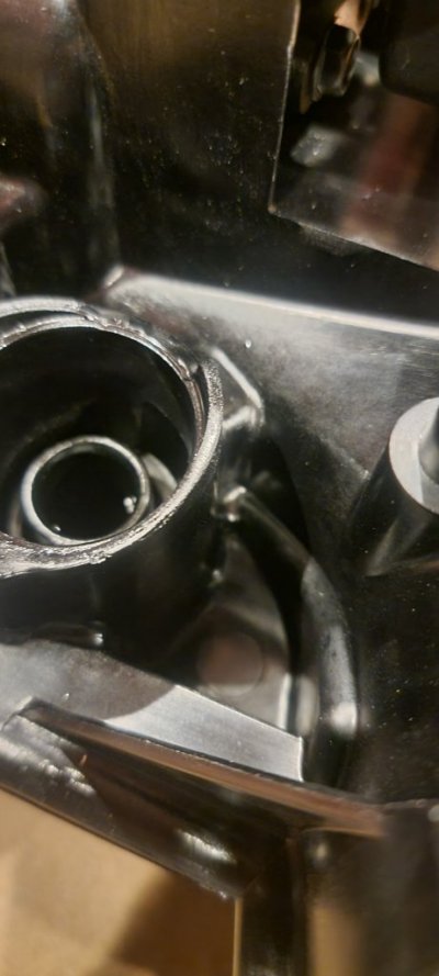

Ah yeah, that's right, I'm an idiot, completely forgot the 6.4 setup was different with the pcv. I haven't seen anything about having to modify to an external pcv setup. Is that even necessary, or can I just cap where that would plug into the S&B? Only pcv mod I recall seeing in regards to this swap was the guy who was modifying to fit a catch can on and he jb welded the hole that led to the intake from the pcv port (pic below). I'll have to do some more digging around on this swap before I attempt it this weekend. I don't do the meta facebook haha. This would actually be my only social media account lol.
