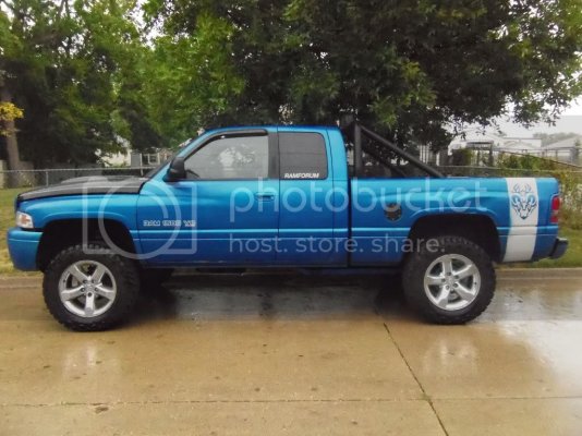

Why would you do that when the bolt pattern is the same? I've seen plenty of 2nd gens with 3rd and even 4th gen rims.

My guess is very little chance 3rd gen stuff would swap that easy. But as hemilonestar stated the 2nd gen should be the same bolt pattern, I have seen many 2nd gens with 3 and even 4th gen wheels.

You just need to ensure the lug nuts are a proper fit at the base. If they are rounded (ball) or flat(tapered) it will make a difference, and the depth of said fastener, but you can buy the proper fitting ones anywhere. I stole my Dads rims from his 04 and put em on my 98 back in the day. They worked fine.
