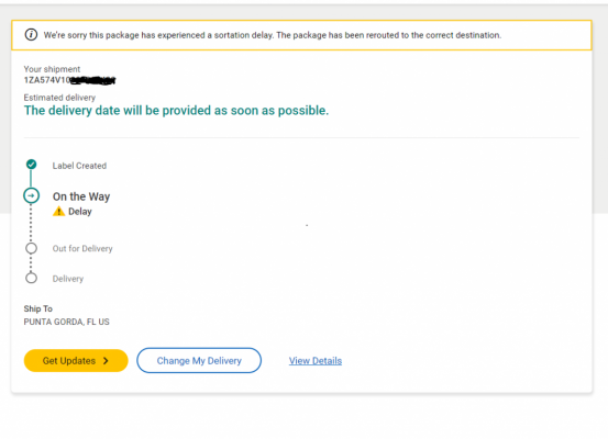

Jeebis. I hope it isn't this bad in the rest of the country. Original delivery date was Yesterday, hasn't budged. I doubt it'll make it today says it's still stuck in a terminal. This is another order of a different type heading to me. I'm beginning to think they're hanging out at the off ramps looking for gas money. Unreal.

FedEx as per normal. Delivery date is still pending. When the lovely and gracious Mrs Czervika is awaiting her purchase, they have no idea how much of a pain in the ass waiting for it to arrive is.

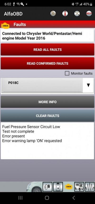

P018C issue is resolved. Swapped out a new pressure switch today. Had to vlear the code with AlfaOBD but so far after
150 miles and a bit of idling no code. So far so good.

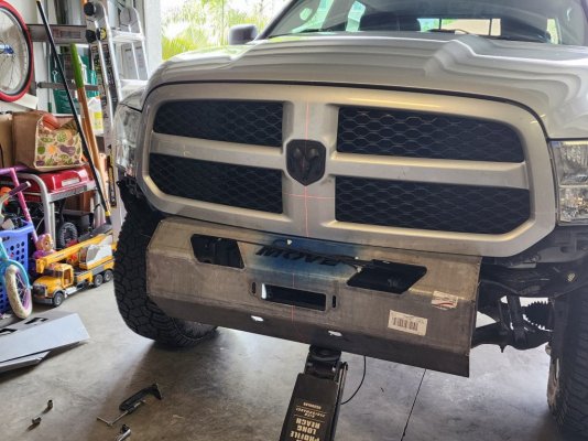

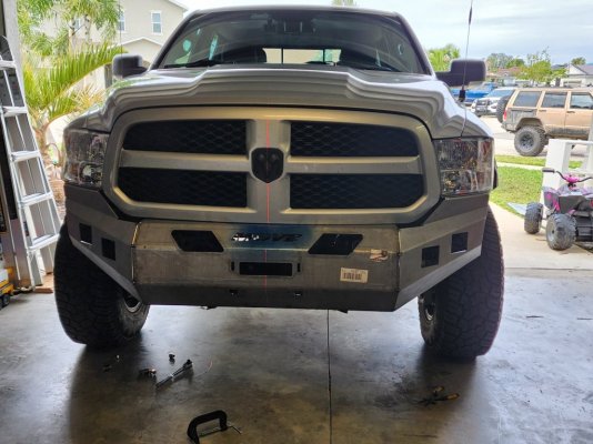

Finally back at it. Vacation was fun. The wife had us put up at the G@yl0rd hotel in Orlando for a bit. Glad to be home. Work is slow so I took the opportunity to start tacking up the move bumper.
Its heavy for sure. Much stiffer than the Hooke Road bumper even just tacked up. Home alone with this beast trying to figure out how to get it back on the ground by myself without f'ing up the truck. Yee haw.
Trying to figure out if I want to TIG or MIG the rest of it. MiG is dead simple but I want to learn TIG. I have supplies and welders on hand for either. Maybe I'll try TIG and switch if I'm garbage.
Itch like crazy from the damned welding blanket though. I hate that...

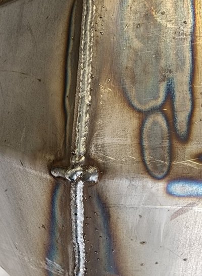

Well, I started with TIG today. The first few inches were glorious. The looked like my days of OA welding after highscool. Then the welds started to go to ****. No matter what I did there were inclusions and severe undercuts. I even turned down to 130amps. Still way to hot. That's when I realized the screen in my lens was plugging up. Switched back to a number 7 cup and all seemed to be ok. By this time though I had made up my mind to switch to MIG.
THIS friggin machine for whatever reason decided it wanted to fight me. Finally got my settings straight, and ran out of wire. I knew I was short and is why I went the other route to begin with.
No, no, I'm not showing any welds. I'm a grinder not a welder. :p

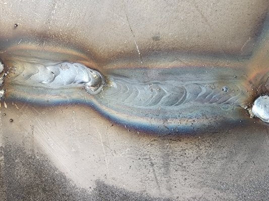

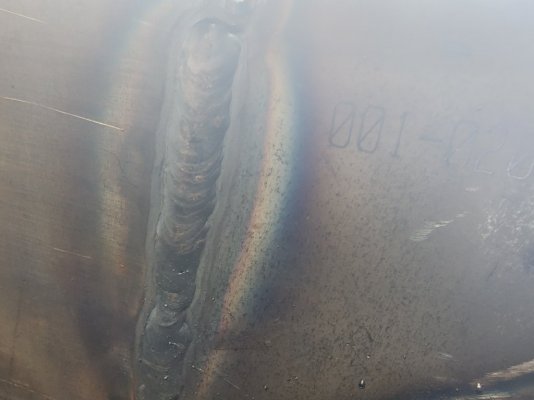

First attempt at fusion TIG. It all went downhill from here.
First time with TIG and filler.
And as I said before I'm a grinder not a welder.
