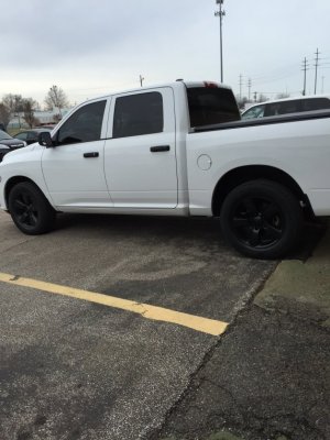

NUTT00
Dec 18, 2014
94
10
Willoughby, Ohio
I used a plastic vinyl tool used to smooth out vinyl to work behind the badges and they came right off. The 3m tape just peeled off as well. It may have helped that it was like 35 degrees :) Then used a little goo gone to get the residue off.

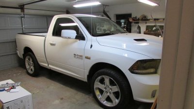

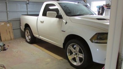

2015 rcsb Sport
I used mig welder wire, pulled them away from the doors as I did it, worked great. My truck was built in January so the tape came off easy.

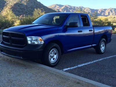

Bird
Sep 20, 2014
181
33
Phoenix AZ
Like just about everyone else I used fishing line to remove mine and goo remover stuff for the rest.
If you do go that route, just know that it's more about the motion of the sawing then it is the force. I found that long strokes side to side with slight pressure worked better then when you forcefully pull down.
