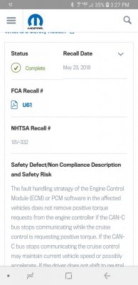

Plot thickens, I had some time today to sit down and look up my VIN to see recalls. Low and behold the recall was already done! So basically, i had a appointment for them to fry the PCM and be out of my truck because some Tech didnt look to see if the updated software was flashed before flashing again. And for them to tell me" its always a possibility that the PCM might die when doing a flash" I think is BS! More like untrained Tech error! Cant wait till tomorrow!!!!!
@ramcares can you help out with this? Id appreciate it very much. Ive have a few bad experiences with this dealership.
Did you have the truck in the shop on May 23rd? I wouldn't trust the dates from that site. I had recalls done on my truck and went back to look and the dates were way off from when they were actually done. My point is they could have just entered it when you brought your truck to the dealer but the date is way off like mine were for some reason.
