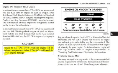

From my '18 CTD diesel supp. Here in WY we get about a month of sub zeros, so it's 5w40 for me all the time
In my 2000 Cummins I put about 1/4 to 1/3 5-40 syn. and 15-40 dino in for cold weather starts. My motor makes too much noise with 100% syn. and I'm curious do you notice that in your newer Cummins?
Being my first diesel, I wouldn't know a noisy one if it bit me on the **** haha. I only have 4500 miles on it and not even shure if it is Dino or Syn oil in it to compare
By the way ya'll what is PUP, that one I haven't heard of
The newer Cummins are a lot quieter than the 5.9 so I would go with what the manual says.
