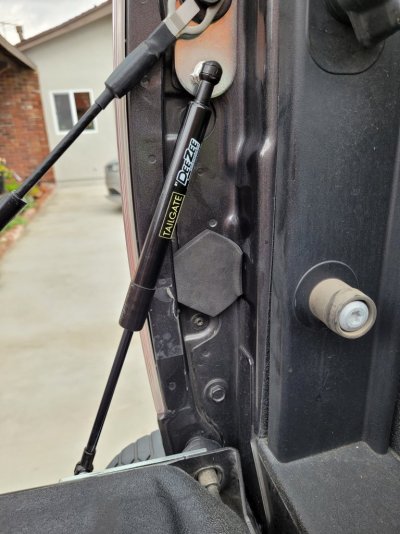

I know this is an old post, but I figured I would post to help anyone who has this issue (I wish I had tried Slapshotz idea first). I bought furnature moving pads for $1, removed the foam, and used an adhesive to stick the foam behind the pinch weld. Now the cable cannot slip behind and get stuck.
