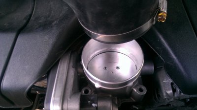

Do not attempt this on your own. I searched the forums and net, very highly mechanically inclined with access to great tools and cnc equipment was used on the project. I now have a beautiful truck that idles rough and upon deceleration must be thrown in neutral to avoid no throttle response whatsoever. The throttle response is great, but will not hold an idle well. I would highly discourage any "brother in hemi" of attempting this mod yourself. I do close tolerance machining (.003-.005) and screwed it up, I thought for sure I had it nailed too.

Not good!! Any pics of what you did do?

Trick is to remain at 80mm under low loads and only have increasing diameter as you approach WOT. That way all parameters are normal at idle, low load and on deceleration. Opening up the entire TB to 85mm will lean you out at idle and throughly confuse your computer.

The computer is definitely confused, I am debating leaving it parked until thursday (when the new one comes in). Maybe if I installed a throttle body spacer it would help, hahaha

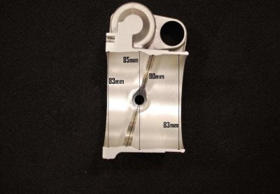

Most of the commercially produced ported TBs use 5-angle CNC Porting
Notice that you start at stock 80mm then progress to 83mm and only near WOT do you hit 85mm.

I started at 82 and tapered it to 85 and apparently started the 85 too soon, the idle is between 800-1200 up and down now. I would never try this again and I hope someone like myself sees this thread. If you can program a 5 axis and know throttle body nomenclature that's one thing, it's best to just leave something like this do a company that's done the R&D and specializes in it.
