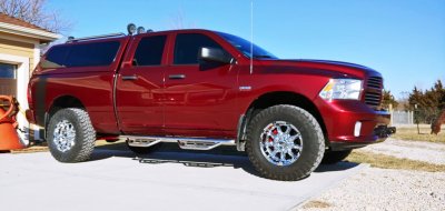

I was really into these wheels when I got them but my doubts have been setting in. Just not too sure about them anymore. Sort of wished I went with something more traditional like a classic D window steel wheel design (that's the Jeep guy in me).
I've been looking to go up to 35s but I'm afraid they will poke too much and look goofy (these are 11.5" wide and 35s will be about 12.5" wide).
What's everyone's thoughts on them? Also could I run a 35x10.5 on a 10" wide wheel?View media item 28862View media item 28864View media item 28863View media item 28861
Edit: bought new wheels and tires. These just bothered me too much.

Same as above. Not a fan of offset tires, but I do like the wheel design...

I don't like the offset, and honestly it seems every 4x4 has a wheel that looks like that these days. The wheel design isn't so bad, just played out and overly common.

I've never been a fan of the rivet-look (fake on most wheels I've seen). That said, the only opinion that really matters is your own.

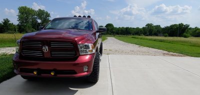

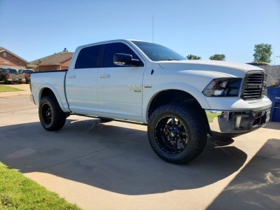

What would they rub on? Even with a level? I'd be running bils at 2.8. your -12s look like they stick out the same as my -24s for some reason
On the inner fenders at full turn mine just barley clear.
My wheels are 18x9s -12 with 35x12.50x18s if they stuck out farther they would rub for sure.

No behind the front tire , about in the center of the wheel well on the inner fender.

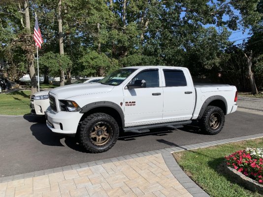

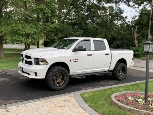

I have 20x10 -18 offset on 35/12.5R20. Rubbed on front fender liners for about 15 minutes. Utility knife fixed that. Definitely needed flares to help with the road crap being thrown up. Lift are Bilsteins at 2.8, Bils in the rear with Airlift 5000’s and a Zone 1.5” body lift.

Ugh yeah I think this is confirming that I either need new wheels or flares.

Slightly off topic... I've never been a fan of the bronze wheel, but damn that's a good looking truck...
