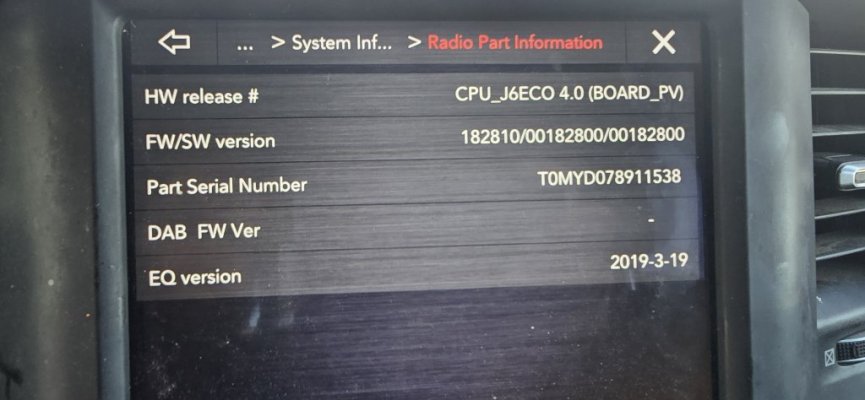

BCSC
Jun 11, 2024
Canada
I also need this update. The dealership is worthless. I've had my truck in there twice and they've neglected two do the update as I've asked them.
Any help would be massively appreciated!
2019 5th Gen Rebel 8.4 Non Nav
Nope, they can't help in this case. We can get your current firmware another way though. PM me your gmail address and I'll get you started.
