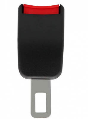

Pick up a seat belt extender. As long as that's plugged in the auto braking function is fooled into thinking you have your seat belt on. Mine looks like this, but there are many different designs. Just make sure you buy one specific for your vehicle...

I ordered this thing. Pretty cheap, but I don’t have it yet to know if it works.
https://thetikit.com/products/chrom...ID6APvn-MAja6tIhBTKND38X-UYeXJPRoCUqAQAvD_BwE
Both of those will work. There's just something about that bottle opener that seems wrong...but I kind of want one LOL. But you'll need to remove either one of those devices in order to use your seat belt for normal driving. With the extender you can release the seat belt from the extender when removing the seat belt, leaving the extender plugged in all the time. No searching for it when you want to move the truck with the door open.
