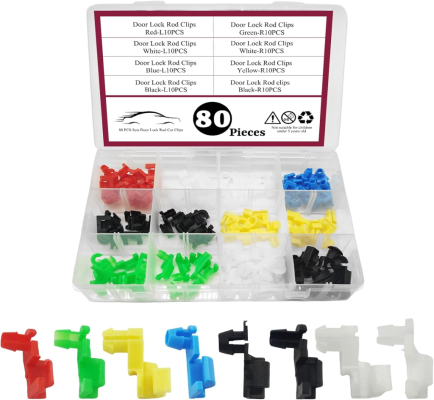

The door lock not moving could be the rod popped out of the plastic clip. These clips get brittle with age and are known to break. Replacements can be bought at any auto parts stores. Just make sure you get the same color clip as the one you are replacing. The color of the clip does matter as the size of the rods can vary in thickness and the color of the clip indicates the difference in sizes..
