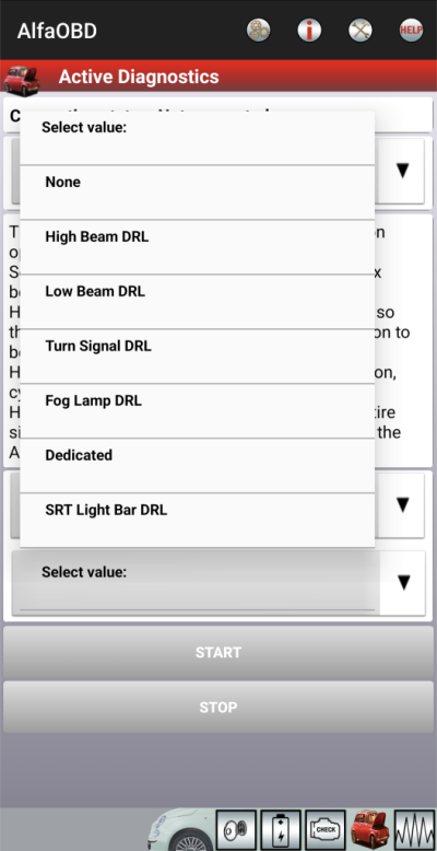

Used my AlfaOBD, switched everything, enabled DRL’s….
The DRL’s are supposed to be clear, white, but mine are amber.
If your truck originally had Quad headlights, there is no Dedicated DRL wires to the headlights. What location did you set for the DRLs? If you picked turn signals it could be keeping the switchback amber.

In order for the drl to be white, you need a dedicated power wire (either from a key on power source or from the OEM drl wiring). If you set the drl to turn signal, the drl amber during the day, but should light up white at night, as the amber portion is the turn signal. When the low beams are on, the drl transitions to the marker lamp, which will be white.

If the truck didn't have dedicated drls, the connector under the fuse box should have the wiring on one side. It's just a matter of running the leads into the other side of the connector and enabling them via alfaobd.

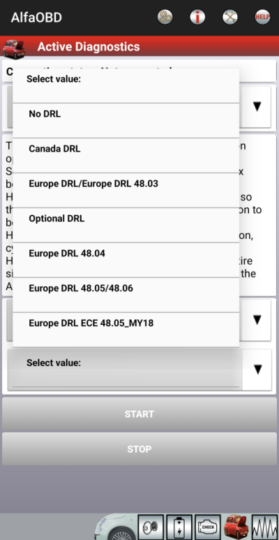

Is there not an option in Alfa to pick what is the DRL? Should be option for park lights, turn signal, low beam, high beam. You pick which light is the DRL.
Ideally, no DRL. Dumbest automotive 'safety' feature there was until blind spot monitoring.
There are options. You can select no drl if you wanted. But parking lights are not an option unfortunately.
