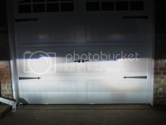

while buying the stuff and doing a retro with JJ's parts will be the way to go for the best output you can get, those ebay lights are not a bad, they have good output with HIDs, they are easy to adjust, the adjustments are the same as factory, and if you like the look of the Halos and LEDs on them, then your set, be carefull on ebay, they started to release that set with LED halos that are dim, make sure it says CCFL halos if you buy those, the CCFL ones are really bright.
here is a comparison side by side of my retro with what jeremy sales and this light, (just so you can decide what look you want
installed pix:
ive ran the black ones too
like i said the ebay headlight doesnt have bad output with HIDs either, here is a shot of a cheap 6k HID bulb in them
any questions on that set of lights i can help you with, i have 3 sets of them laying around lol
i wouldnt worry about the bulbs they give you with these, my friend bought that setup and they were fine on his 07, just make sure you get a low temp bulb like 4300k, 5000k, or at the highest 6000k, if the worst case would be that you need to buy a relay harness from jj to make them work flawlessly, thats what i did with mine was use JJs harness that he sales
