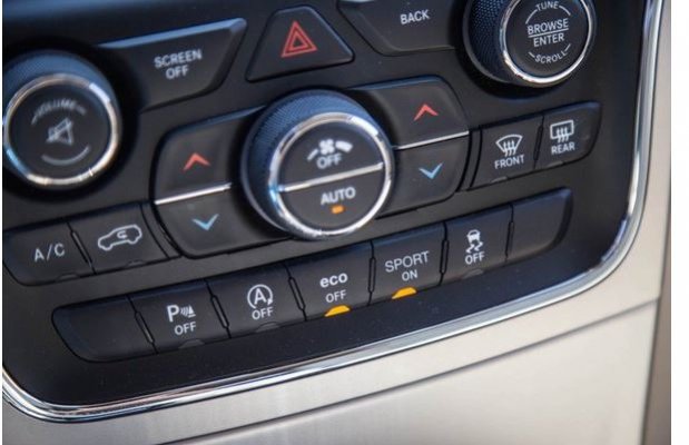

POSTED a lil info below I found searching: Also found, on like Jeep Overlander 2014 and more, they actually have an ECO mode switch on center stack, saw it on dashboard pic of Grand Cherokee 2022 (so I guess U know I do not ride around in Jeeps, not since Army M151a2/3's, lol). Now I know we do not have it on Hemi and V-6 ED, cannot remember ever being in a Pentastar 6 Cylinder truck, so unknown if U have a "eco Mode" switch. Pretty sure all computer controlled.
ECO MODE (JEEP INFO) (Apparently Jeeps have a Switch, had to look it up, lol)​
Eco Mode helps improve fuel economy by adjusting the transmission shift schedule, idle speed and interactive deceleration fuel shut off. In models equipped with a V8 engine, Eco Mode also adjusts Fuel Saver cylinder deactivation. Automatically engaged upon vehicle start up, Eco Mode activates the available Quadra-Lift® air suspension system and lowers the Jeep® Grand Cherokee when the vehicle’s speed exceeds 88 kph (55 mph). On 4WD models in 4H, the system alters the front-to-rear torque split to help increase fuel efficiency. BELOW Jeep center Stack which is not in RAM trucks (Eco switch).

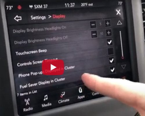

Holy snot balls! OK, back up, I noticed my ECO light not working on my 2020 Longhorn. Tried an ODB2 scanner to start with, well, just because. Nothing. So a quick research of these great forums, and sure enough, this option was turned off in settings. I never did that. Hurst my little brain to try to figure out why that would have turned itself off. Anyway, you guys are awesome!
RamDiver
Jan 23, 2022
5,791
12,220
Marlborough, Ontario Canada
2021 DS
For anyone looking to add or confirm the state of the Eco notification to their EVIC, the soft switch is stashed in the Uconnect settings, at least for those with a Uconnect 4C or newer.
Uconnect/ settings/ display/ Fuel Saver Display in Cluster.
