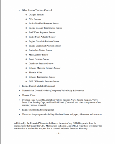

@RobertD did the truck have the AEM update? It's possible the truck is under the AEM warranty. Basically anything to do with emissions (that includes fuel and air delivery) is covered for 4 yes/48K miles from the date the AEM was performed.

Yes, I had the AEM done. How would I know if this would be covered? I still have the paperwork on the warranty. I'll get it down and read it again. The service manager from the dealership was blaming water in the fuel. I just don't buy that. Of course, the AEM warranty was never discussed by him. It looks like the high pressure pump is a know problem with a lot of manufacturers not just Ram. If this is true it sad that Ram would put the customer on the hook for a know issue with such a high cost to repair.
Check the paperwork the HPFP is listed. Go there and pull your own fuel sample to have tested and if I'm not mistaken the Water-in-Fuel sets a dash indicator.

I check the paperwork I didnt find the HPFP listed. Some of the fuel system was, injectors, lines. But, the first three linses of the warranty paperwork states void is cause by accident or abuse. I'm guessing they will say water in the fuel is abuse.
This is straight from the AEM settlement paperwork: High pressure injection pump and regulator.
It pretty much covers anything that handles the fuel or air going through the engine. About the only thing it doesn't spell out specifically is the intercooler, but the turbo and the rest of intake assembly is mentioned.
