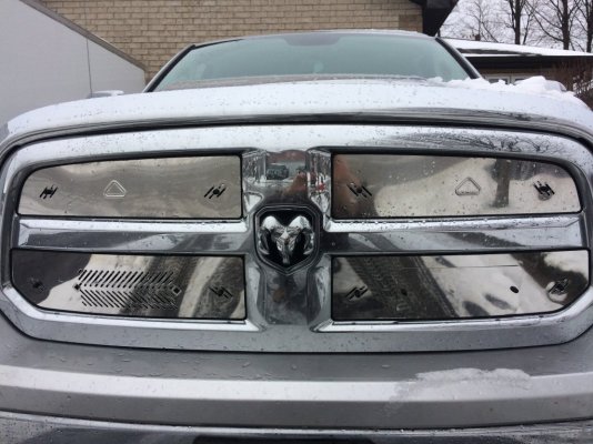

When the temps hit 0°F and below the entire grill can/needs to be covered. If you have the winter front that came with your 2015 it probably doesn't have the adjustable flaps. The later model year covers have the adjustable flaps(cover with flaps:82213959AC).
If you do have the cover with the flaps and they're all closed, you probably need a thermometer.
I have stainless steel grill inserts and anytime the temps are at/below 20° run all four with just the lower two restricted openings, as the temp gets colder I close off the rest. If the coolant or oil start topping over 220 , there isn't enough winter front open.
This is what it looks like with just one lower restricted:1000034506.jpg
