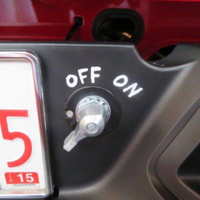

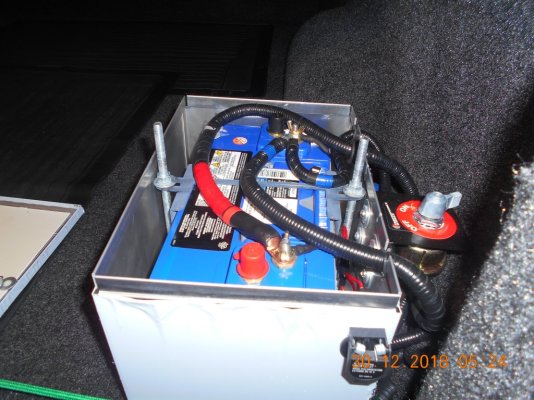

I agree that's the only way to make a good cable end. I haven't used the braided stainless cable yet,as they're pricey as hell up here,but if i'm doing a long run under a vehicle,i run the cables inside garden hose.
I also upgrade the feed over to the fuse box,and ground everything
