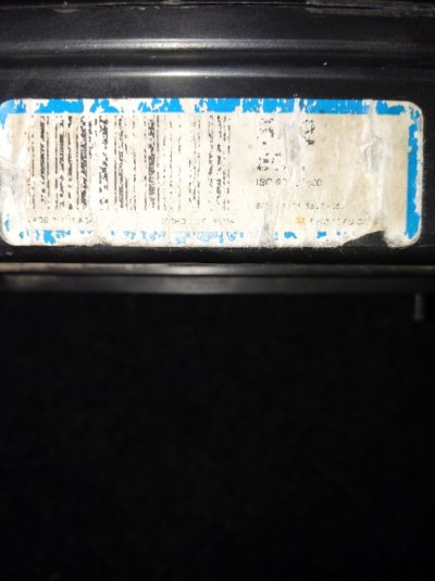

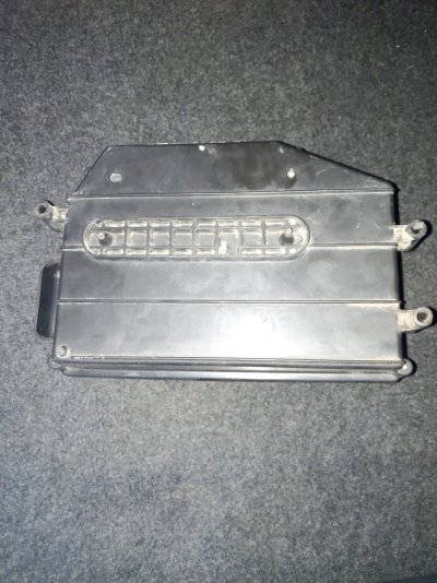

I was looking to replacing the OEM EC module with another.
I am unable to provide the OEM No. to a parts store.
The parts department at dealership gave me a full page of possibilities of ECM's.
The OEM unit I have is ECM 542.
The seven digit OEM No. Is no longer visible on the sticker attached to the ECM.
I was advised by a senior member that this could be the problem on a previous thread I've posted.
Any suggestions would be appreciated.

The PCM you are looking for is
4379542.​
There are a few available from eBay.

I decided to open the ECM. Inside No. 4379351 appeared.
I decided to Google it , and got a hit for an: " '89 D 150 with 3.9 liter with A/C".
That is not my truck !
