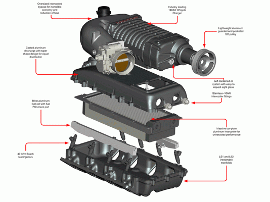

Trup,
This is the setup that has my attention. Unfortunately there isn't a manifold available for the Hemi .....
Yes it's a whipple.

That's badass man! They making a production version for us any time soon? Whipple makes awesome twin screws! Saw one on an f150. It was a diamon on a **** lol.
I thought it would be cool to put the 6.1L intake manifold on our 5.7's. Heard it can net a few more ponies. Not enough to counter the cost though lol.
