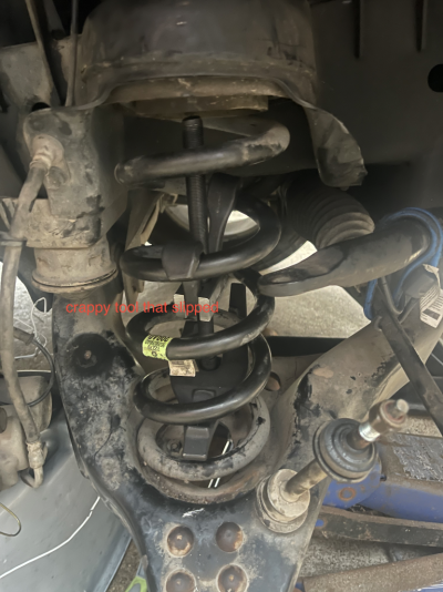

Got my coil out with a tool that was not the best.It caused the coild to bend to one side and it would not go back into the control arm and the tower due to the bend. then it let loose the compression and then I had a uncompressed coil. Did not injure me, but scared the crap out of me.

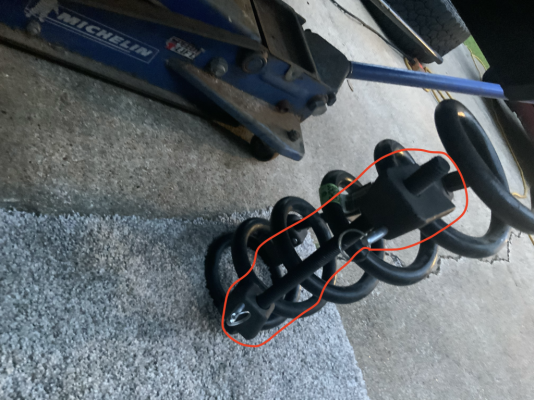

I switched to an external compression tool with two rods instead of the other design. It worked well, but when I tried to put it back into the truck, because it was outside the coil, it would not seat into the right position in the tower and control arm. It is now so tight due to compression on the tool that I cannot turn the nuts to loosen the tool.

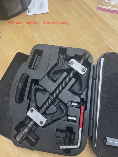

SO, how have you gotten a spring with the above issues to seat? I have a different internal coil compressor; see the picture of the new tool below. But in order to try it, I have to get the external one off.....

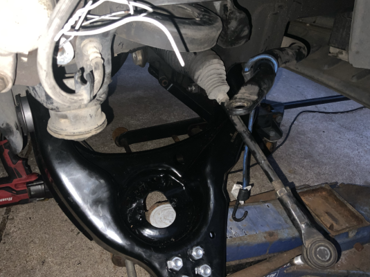

Pick of the tool on it now below, you can see from the picture, circled in red, the external nature of it prevents the coil from going into the tower. Finally, I have included the screwy tool that got the spring off and the opening where the spring should seat.
