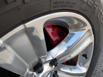

old thread but i have a "Franken-Ram" ..former '03 4.7 now powered by an '08 6.1 with a truck manifold... it is a great truck! Runs strong, though it throws a code now and then... the guy that built it in Miami did a great job! I dont know how he tuned the '03 ECm, but it all works well... " '03 Ram 1500; '08 SRT-8 6.1; '12 20" wheels; SRT brakes and rear".. what a "Franken-Ram"!

Why does your profile say 6.5 then lol? Also curious about your brakes, as they don't look like the SRT brakes...these are the SRT brakes:

.. Back on the site.. Good catch on the engine size HemiLoneStar.. it was a typo. As far as the brakes, that is what the guy i bought it from stated. I "assumed" he was right since they are slotted and bigger than my first '03 Hemi Sport i had years ago.. It is always great to have someone as observant as you are to get things right for the rest of us. Thanks!

That's why I was curious, not to call out false info, I wanted to see if there was a cheaper viable alternative for people. Do you have any close ups?
No problem, good catch. YOu know how many times i have had to restart a profile on this site? This is my third RAM since '03 and my fifth time resetting on this website... so I am sure a typo or two might happen..
As far as engine pics, i'll see what i can do when i get back home.
