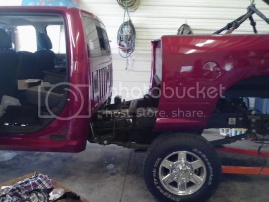

Bros got the Air Dog II. No issues with the couplings. I kind of thought it was bs till we installed it. EGTs went down and it made the motor a lot quieter which was really dramatic.
Pulled the bed to install instead of dropping the tank.
