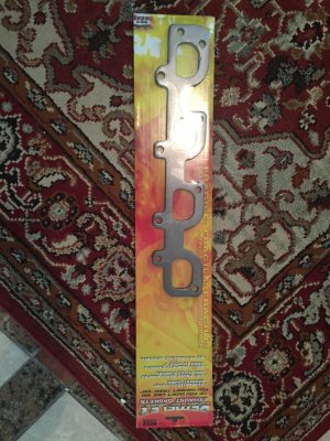

I run Remflex gaskets. The fact they don't need retorquing is great,mine have never leaked.Personally I think they're superior to the OEM 6.1 gaskets that most guys use.I ran the OEM 6.1 gaskets for awhile,but then found the Remflex gaskets and I won't use the OEM gaskets anymore,lol

Some use OEM bolts and 6.1 gaskets (beefier), I went Remflex (super beefy) and Stage 8 fasteners but I also went ARH LT headers.
If you put the locking clips on,you're gonna hate pulling the headers again,lol. Stage 8's aren't required and have actually been known to cause issues with the knock sensors on the Hemi's.Most tuners will tell you not to use Stage 8 bolts on a Hemi,or if you do,leave the locking tabs and clips off.Not only that,you can't really get all the lock tabs on all the bolts . The bolts that come with most headers are perfectly fine,and are already included with the headers.
