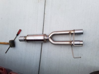

Carven Progressive exhaust system , no rust issues. :)
