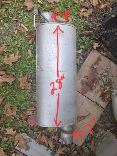

Lol! Here's what I have. It has 3 1/2" in/out pipes and its approx. 7 1/2" deep. Other measurements are on the pic.
thanks for checking that for me, that clears a few things up
if i measured mine correctly, the main body is 26 inches and the in/out pipes are 3 inches (one of them is 2 inches shorter, so overal length it might fit)
i think thats enough of a difference to make it a royal pain to install yours, and it would require some cutting to get two 3.5-3 inch reducers on both ends to make it fit with the existing tubing
it might be an option though
I certainly wouldn't enjoy trying to make it fit :emotions122:

Having seen Dredgers pic, I think a simple 3-3.5 reducer installed where my stock muffler would go, and then a 6.4 system from there would do the trick
That opens up options
