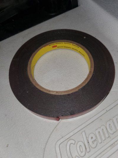

Sorry .... Anything worth doin, is worth doin right .... Take em off, retape em, clean the paint with alcohol, and reinstall em .... Good for another 10-15 years
Absolutely agree with what Bowers said, when I re did mine, picked up some 3m tape from napa, used a heat gun to pull the remaining tape from the flares off , cleaning/prep is the most important thing then when I re-installed something I did that seemed to help I had a 6ft 2x6 that I rested up against the flare to apply pressure, which seemed to help seal overnight,
Do not use crazy glue, some of that stuff has chemicals that will eat away at your paint.
This is what the roll looks like of 3m tape 59669fe2768fcc040f79c566eaab016e.jpg
