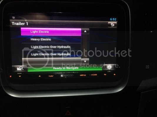

https://www.adsdata.ca/...I'm kinda thinking this is who makes it, but either way, I don't care who makes it! To answer the OP's question, if you were to buy a HU that didn't support car features, then yes, your trailer brake will still work. It will just be stuck on the last setting you had on the 5.0 (example "trailer 2, heavy electric"). You'll still be able to adjust the gain on that setting. Otherwise, like said before, and like the kenwood you pictured, get a HU that supports car features and use the maestro.

I believe you're thinking "Maestro" and not metra. If you get the maestro with a compatible head unit that has car features then you'll still be able to choose between "light electric, heavy electric, etc". I have the pioneer avh 4200 nex, and it retains those options

The menus and car features are in the actual HU. The maestro activates them by plugging into the OBD2 port. With my pioneer, I'm able to use the climate controls, heated seat, tire monitor, park sense, engine diagnostics, and vehicle user settings, all through the radio.
So keep in mind, if you don't get a HU with these car feature menus, you will also loose the ability to change things like headlights stay on after locking truck, horn sounds when you lock your truck, illuminated approach, etc.
