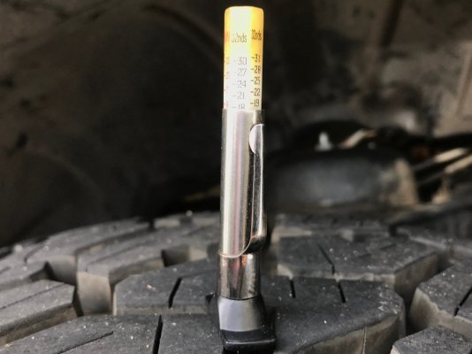

I measure the thread at 19/32 for the 315/70/17 E rated, 13/32 for the 285/70/17 P rated, brand new
I have about 5k miles in the E rated ones, thread is down to 18/32, all 4 corners wearing down the same, running 36 PSI in them, used chalk to determine best contact patch. Surprisngly the P Rated nes in my other truck are wearing down more in the back, currently at 10/32, while the fronts are at 12/32, running 40PSI, I need t check with my tire shop how many miles i have in those, Wife is the one running that truck, and i don't think she had done a tire rotation first :), so i need to take care of that truck next.

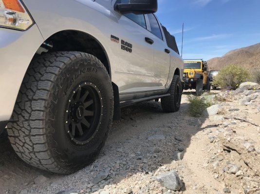

I haven't reached the 10k miles mark just yet, did the 1st rotation at 5k, but wanted to update the thread as the tires have become little noisy with miles, not super loud, but they're not quiet like new for sure, i'm prob around 7-8k miles, wearing down evenly front/rear, haven't noticed any issues in this regard, still running them at 36 PSI and that will be their permanent PSI setting in my truck.
Traction in the rain is outstanding, had the chance to test them out during our recent rainstorms , i have to give the truck gas on purpose to overpower the tires when raining from a deadstop, the tires seem to be very resilient to hydroplaning when going through big water puddles and i like that, will see how the traction in the rain remains as the tires age with miles, but so far so good.
Dirt and soft sand are on par with other AT tires, excellent traction and control when slidding around the trail with some speed, they're weak on mud as expected, you can see here how wet dirt will build up, though they clean out nicely if you give the tire some throttle to shake up this crap, not expecting this things to move out very well on slicky mud anyways, i avoid mud like the plague, though sometimes there is not escape to it, i try to go around mud as much as i can.
44421887180_2597f7e6e7_h.jpgUntitled by Wrangler RSM, on Flickr
31299987867_63e9babf70_h.jpgUntitled by Wrangler RSM, on Flickr
Will have them in the snow in a couple of weeks and see how they'll behave,i'm expecting excellent manners in this department as well, rain and snow were the main drivers in my choice, asides from price, and so far, the AT3W's are delivering just fine.

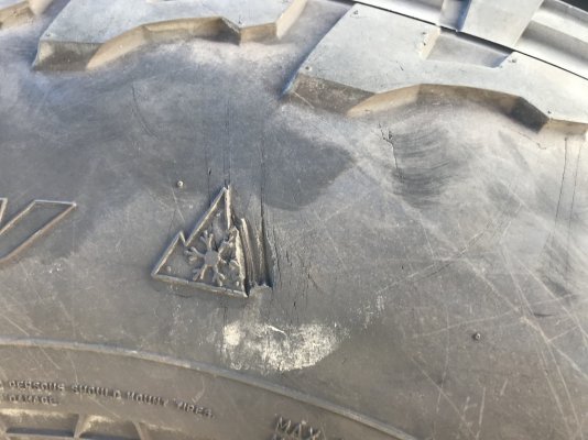

Wanted to update the thread as i did the tire rotation today at 77331 miles. 14k miles on the tires now and they're wearing down fairly well.
4 of them are down to 16/32 even from their 19/32 brand new , 5th one is at 17/32 as i introduced that one down in the rotation at 5k miles, so they're wearing consistantly at the moment 1/32 every 5k miles, that's even offroading the truck every other week or so. Still running them at 36psi and have no reasons to change that.
No issues so far, noise hasn't increased, still little noisy compared to other AT tires i've had, but nothing to complaint about. I have rubbed their sidewalls against the rocks and now i have a cut in one of them and a little sidewall chunk out in another one, but that's why i wanted strong sidewall tires anyways though these are 2 ply but on the heavy side.
