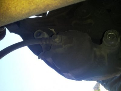

First I un bolted the two bolts to take off the brake caliper. You'll need a pretty good sized allen wrench.

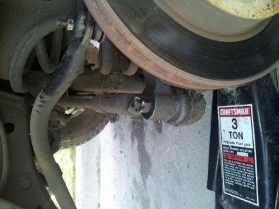

Then take out the castle nut on the tie rod end. And the cotter pin first o course.

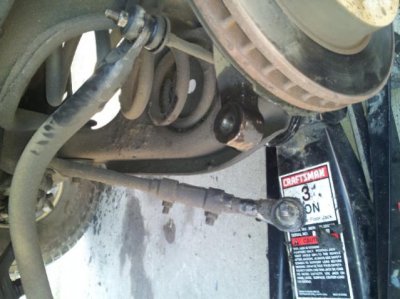

Then whack it til it falls apart lol.

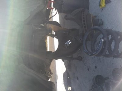

Then un do the sway bar on BOTH sides and twist it up and towards the front if the truck to get it out of your way.

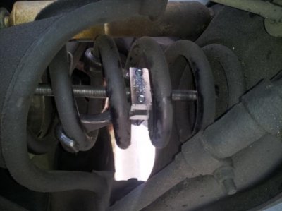

Then I used a coil spring compressor to compress the coil.

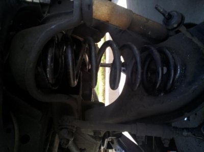

Then I took iff the other castle nut off the upper ball joint. And whacked it til it fell out and I let down the jack to ease pressure off the coil and take it out.

Sorry in the first pic I had already taken the castle nut off and didnt wanna put it back on just for a pic lol. You get it tho.
