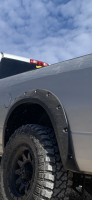

Dunno about a film. But mine came with a rubber gasket and seems to do a very nice Job..... however I’m not to concerned about scratches as you can tell lol
