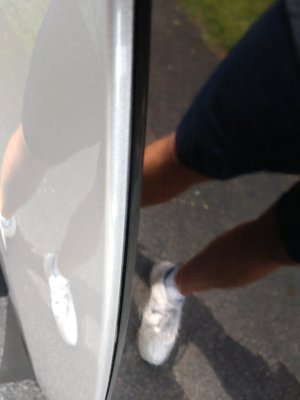

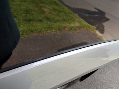

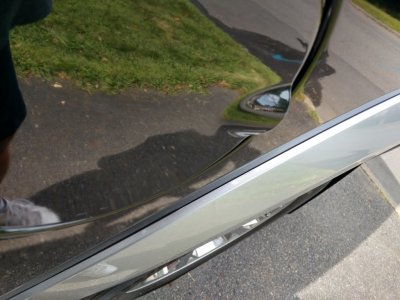

Well I took care of the rear drivers side flare this afternoon. It's really not all that difficult, just time consuming.
After taking the screws out, I used my heat gun and a plastic putty knife/spreader to get between the body and flare. Went nice and slow and then popped out the plastic grommet located at the top.
Used Goo gone and the heat gun to get the old adhesive off the body. Then washed the side down, dried it, and then took my buffer with some Machine Glaze and got anything that was left. I then waxed it. Looked mint. Even thought for a few minutes of taking them all off.
I then took a razor blade and very carefully took the old tape off the flare. Wiped both areas down with alcohol wipes, put the new tape on. Held the flare in place by using the grommet plug. Peeled the tape off and pressed into place. Put the screws back in and done. It is time consuming but it had to be done. Next Saturday it's the passenger front.
