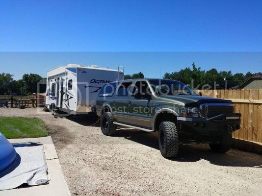

I've done it with my truck as well. Hauled the boss's Ford 7.3 Diesel Excursion on a tandem flatbed trailer across town after it broke down. Curb weight is 7700lbs, then with the added Winchready front and rear bumpers, Warn 16.5 winch, 6" lift, 37" tires on 20" wheels, it weighs in at almost 11k across the scales. Add on the trailer at about 3k dry, that was WAY over my truck's capacity. But, slower speeds on back roads I made it from about 30 miles with no problems.
Picture of said Excursion for reference to size.
But an occasional load here or there isn't as much of a concern. My concern is a single cab short bed truck DESIGNATED for towing a load more than double the truck's weight.
