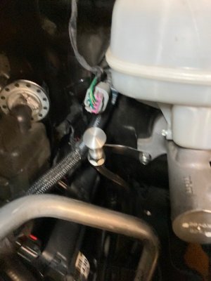

Just like G-Ride990 said . . . Lokar P/n ED 5015-24. Says it doesn't fit but it does. I installed it on my truck & it works great. I have never attached pictures but I will give it a shot. I'm VERY NEW at this forum stuff.dipstick closeup.jpg dipstick zoom out.jpg dipstick zoom out.jpg dipstick closeup.jpg dipstick zoom out.jpg
