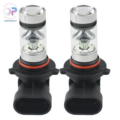

If the wiring harness has this connector and the bulb has this connector , I will need an adapter or pig tail to connect , right? Sorry for all my dumb question , I just want to make sure I have all the parts I need . I assume I will need the jumper/adapter ThanksIMG-20120206-00223.jpg 9006-LED-Fog-Lights-bulb-Fit-For-2003-2008.jpg
