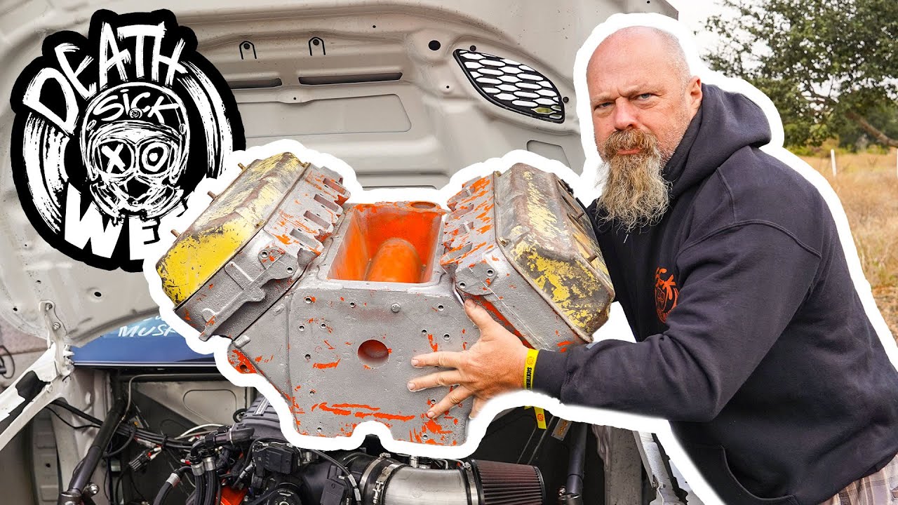

The BGE stands for Big Gas Engine,and is cast into the truck 6.4's,the Hellcat 6.2's and all car 6.4's after 2018.It's generally a good block up till about 1600 rwhp if it's been filled with block fill.Basically block fill is like a cement that you pour into the water jackets to stiffen/stengthen the block,but that usually takes it out of the daily driver catagory unless you're running straight methanalol or alcohol for fuel.This article has alot of good info on the trucks BGE block,and is worth spending a few minutes reading through.
