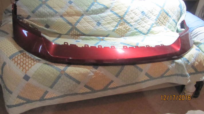

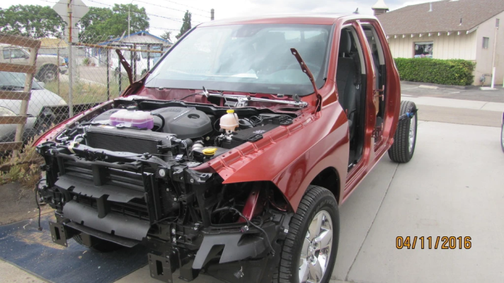

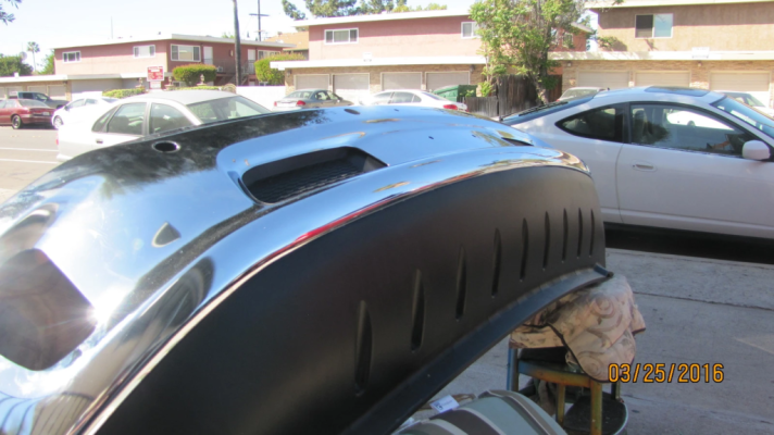

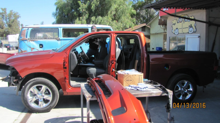

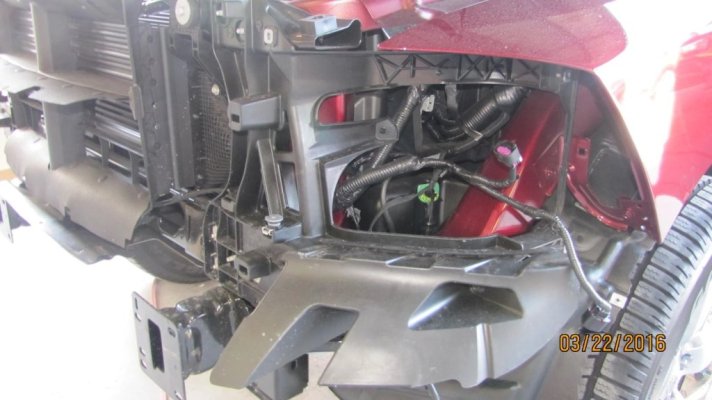

Those 2 pix look like my 2016 Ram did during the switch over to the Sport Bumper.
Upper Valance
Tow Hooks fastened to the back side of the Bumper Plate

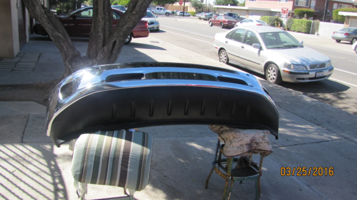

That row of bolts at the bottom, is where the large Plastic Air Dam fastens to the Chrome Bumper

I have forgotten whether these pieces went with the Chrome Bumper or the Plastic Bumper.
I am leaning to them being part of the Plastic bumper
