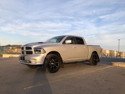

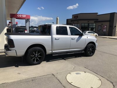

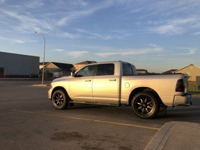

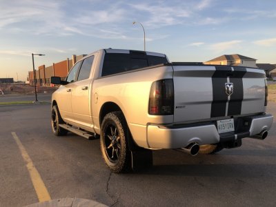

Over the course of 4 evenings I have 14 hours into doing a complete interior, exterior and engine bay detail. The first evening I did the engine bay, the second evening the interior, the third evening I did the wheels and tires, the final evening was the exterior and "touch-ups"
I’ve only posted the exterior images as the rest is boring! You'll notice the last image has the vinyl removed between the windows. My pressure washer damaged the vinyl during the wash process so I pulled this off post detail a few nights later...so technically add another hour or so and a 5th evening.
