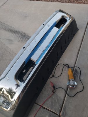

I had seen allott of bumper mounted light bars on the 2500's and sport model, but very few with the 1500 classic G4. I had the issue of having the ugly Ram 1500 G4 2019 classic bumper that did not have the full cutouts to fit a light bar. I decided to cut the bumper and outfit a 42" light bar in the bumper. The job was pretty easy and only required a grinder, die grinder, bolts, and aluminum spacers. I love the result.
View attachment 220892 View attachment 220897 View attachment 220895 View attachment 220898
I'll say that's nice job, looks really good, and flows well with the bumper. It doesn't stick out past the bumper like I've seen on some others. Personally, I wouldn't tap into the high beam though; perhaps the fogs maybe or the low-beam? I know you said you didn't want a separate switch, but I've seen a few applications with the s-pod (switch-pod) that look good.

Looks like your bumper has braces, but great job
