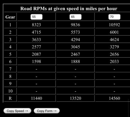

what are your rpms at with 35’s and 4:88? 55 65 & 70mph
I’m trying to decide on 4:88 or 5:13 with 295/70/18
Use the calculator. Add about 100 RPM for wind resistance.

Here is stock vs 5:13 w 295/70/18.
4:88 with 295/70/18 looses rpm C08C8C80-2496-4B1C-8B49-D6AD72F14258.png

I have 275/65/20 which is 34 inches. Your 295/70/18 would be like 34.25 inche. Basically same as mine.
I had 4.10 stock, and love the 4.88s. Towing I may would have liked 5.13 better. But when empty, I love the way it drives now with 4.88s and I'm in WV as well, so lots of hills and mountains.
