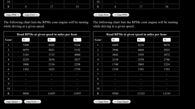

Getting ready to start shopping for places to do my gears.
trying to decide what ratio I want.
Biggest tire I will go with is a 295/70/18
This first chart is 4:10 with 275/70/18
vs
4:88 295/70/18
looks like I would loose rpm.

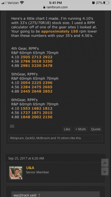

compare this to the second chart. AEDB97E4-A965-4E46-AF00-12823A92F542.png0A72A299-6B07-450A-84C3-25BA0B20ED0D.png

Use a calculator, no guessing required.
Select the 68 RFE in the drop-down menu for your transmission. It’s the same exact gear ratios as our 66 RFE
Then all you have to do is put in your desired gear ratio and tire size and then you can mess with the calculations at the bottom and see your exact speed and rpm.
Add about 50-75 rpm for wind resistance
http://www.grimmjeeper.com/gears.html
I have 4.88’s and I’m running 35s. I kinda wish I went to 5.13’s.
IMO
33”tires need 4.56
34”tires need 4.88
35” or large need 5.13
Again... JMO
My next set of tires I’m going to go a tiny bit shorter but a little wider. I’d like to get a tad more RPM.
Sent while firmly grasping my redline lubed RAM [emoji231]
what are your rpms at with 35’s and 4:88? 55 65 & 70mph
I’m trying to decide on 4:88 or 5:13 with 295/70/18
