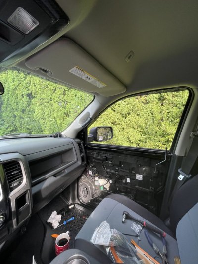

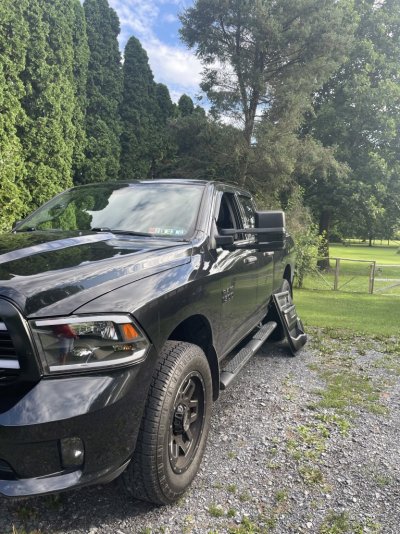

Just installed tow mirrors. Got them on Amazon.
Siziom Towing Mirrors Compatible with 2009-2018 Dodge Ram 1500 2500 3500, Power Heated with Turn Arrow Signal Light Puddle Lamp Extendable Manual Telescoping&Folding Pair Set Tow Mirrors, Smoke Lens https://a.co/d/1hmjbEa
Need to wire in the reverse and running lights. Anyone know where to tie into those inside the truck?
Waiting for my security cable and Bluetooth OBD 2 reader to get here today so I can use JScan to turn on puddle lights and turn signals.
View from drivers seat is much better. Can’t wait to see what its like with camper hooked up.

They look great I'm thinking about getting these as well, one thing I was pondering with them, how do you extend them when towing?

Just pull them out. They are manual and just slide.

Looks good. How does the distance between the door/mount and the outside edge (when slid completely IN) compare with the original mirrors?
