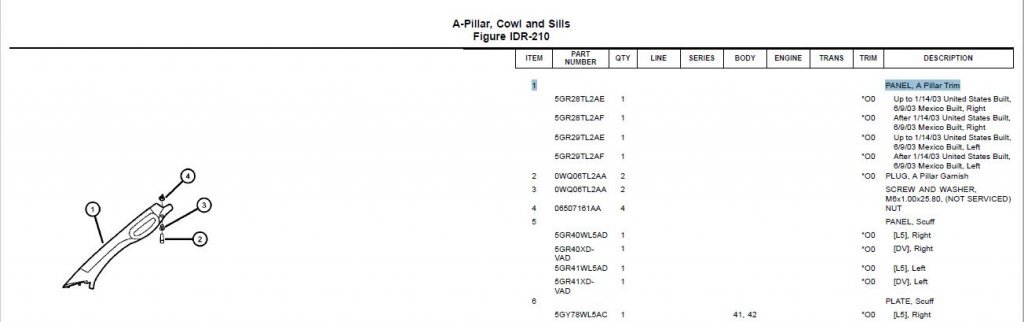

Well, the factory just calls it "Panel, A pillar trim" lol.
Full size humans actually using it to haul their full weight in is why this exists: https://www.genosgarage.com/product/imco-rpr-kit/interior-replacement-parts
I would've loved to see what was left of the mounting points on yours lol.
