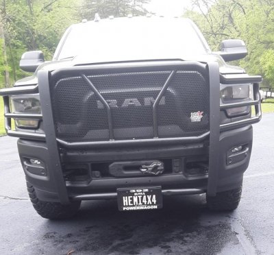

I hit a deer 3 days after bringing mine home.
Westin HDX.
The dent next to my license plate was the only damage...
But I agree- a full bumper/guard unit is better.
Westin HDX.
I love that, wonder why Westin's website says it excludes PW models? Did you have to make any modifications to install? I had one of these on my Duramax and I want one on my PW for sure.

Yes, PWs winch is in the way.
Fortunately, I had the dealership install it.
They had to fabricate lower mounting brackets for it to make room for the winch.
Didn't even charge me extra for the hassle.
When you say the winch was in the way, do you mean the winch was in the way of the supplied brackets?
