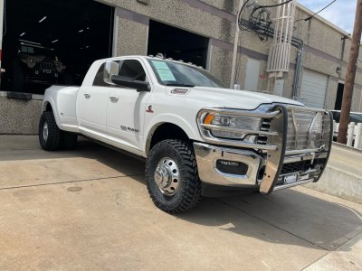

I cut a hole in my Westin HDX so front camera works fine. Its a heavy stainless mesh so won’t rust or distort. When my RoadArmor bumper arrives I’ll take it off and sell it. To me, the Westin fit the lines of the 5th gen Ram best

I had a Westin HDX on my 1500 Laramie.
Liked it so much I put one on my PW.
Front collision warning beeps at town speeds so I have to shut it off, and I lost my factory tow hooks but other than that it's great...
